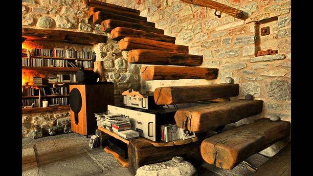

Originally posted by beTon
[1] https://www.stairs-siller.com/floating-stairs/ [1]
