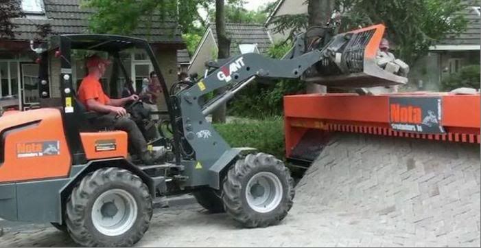

http://www.tiger-stone.nl/
The tread-tracked machine is electrically-powered, and has few moving parts, so noise and maintenance are kept to a minimum. It stays on course thanks to built-in sensors, which follow the curbs. According to Vanku, a machine with two operators can pave at least 300 square meters (3,229 sq.ft.) of road per day, whereas a single conventional paver on their hands and knees manages between 75 and 100.
The Tiger Stone is available in four, five and six-meter (13, 16 and 20-foot) widths, and costs from €60,000 to €80,000 (US$81,485 to $108,655). There’s no doubt that a lot of home-owners would like to see a much smaller version, that they could rent for creating garden paths and patios.
http://www.gizmag.com/tiger-stone-lays-paving-bricks/16951/
Edited by Max - 01-Sep-2011 at 22:35
